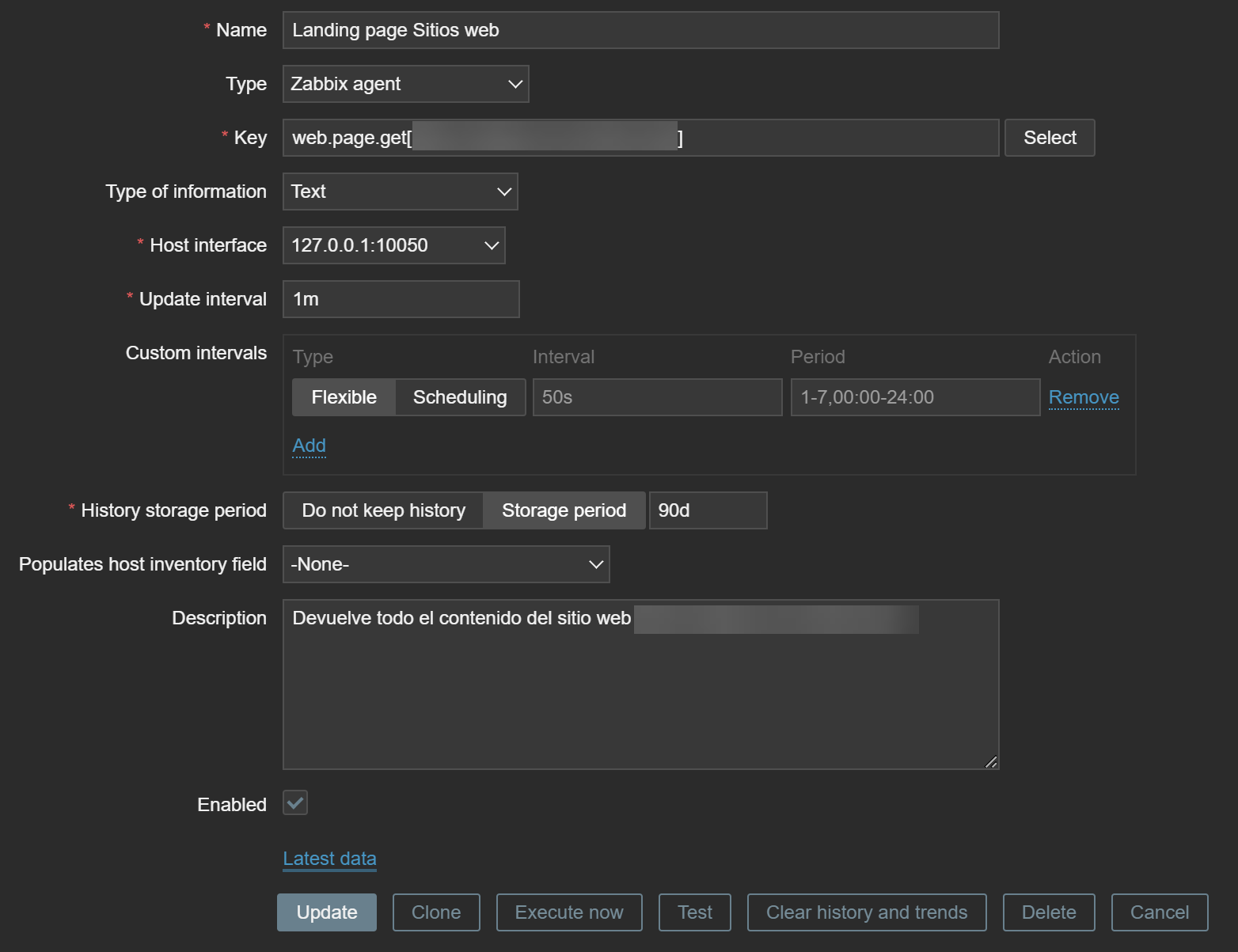

                            Beautiful Markku, this is the correct answer!
                            I've created a HTTP Agent to get all the content of the website:

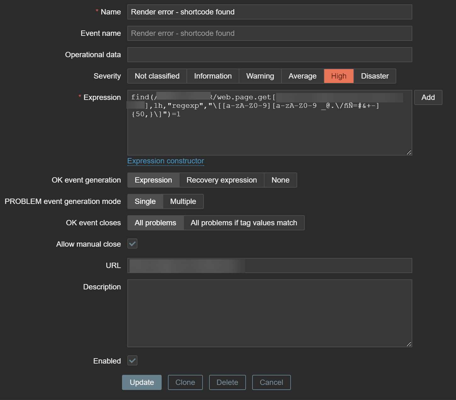

                            And then a trigger to found a reggex with undesired content in my website:
                            For future reference, this is a good example: https://blog.zabbix.com/handy-tips-8...unction/17481/
