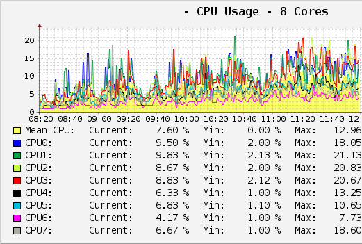

Please advise how can I build graph prototype for a standard "Template SNMP Processors" so it displays all discovered CPUs on one graph. Something like on attached screenshot. Thanks!
In the same way I'm going to graph auto-discovered SNMP OIDs for Asterisk based on discovered data as listed bellow. I've build a discovery rule with a graph prototype which graphs every type of channel in a separate graph.
As a next step I would like to aggregate this information and display info about all discovered channels on the same graph. Please advise how it can be done.
