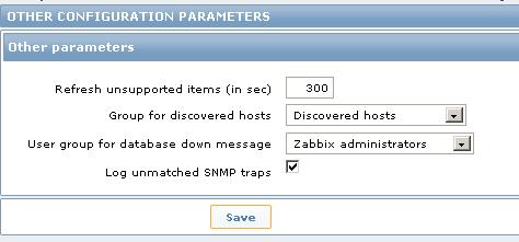

    Is there a configuration parameter that tells the server and/or agent when to try an item again to see if it has become supported? I only see a reference from 1.1 that the default is 10 minutes, but I can't find any where in the conf files to set this.
    Does anyone know how this works?
    Thanks.

    Go to Administration --> General and on the dropdown at the top right, select "Other".
