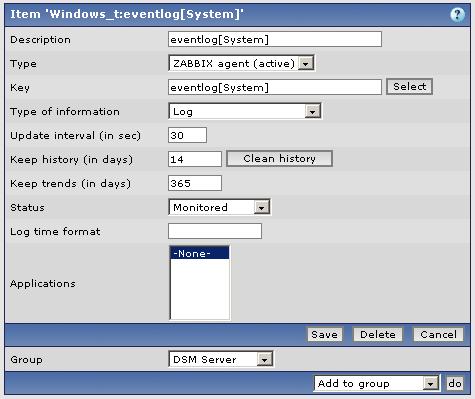

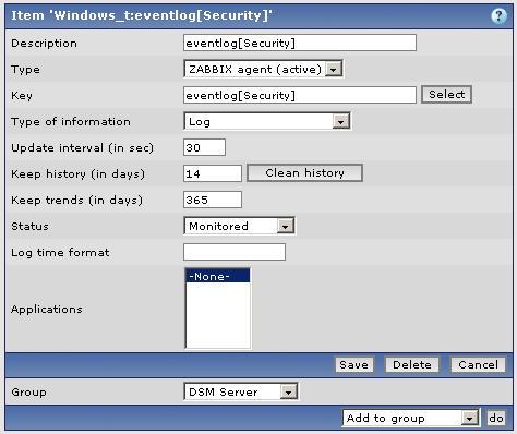

                      May be, this helps you
                      Screenshots
