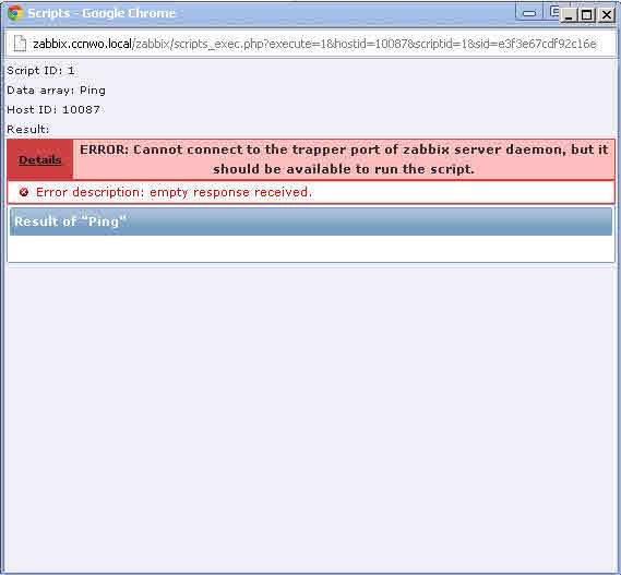

    Evan,
    No, not being blocked.
    I have attached a jpeg of the window.
    Thanks.
    Bryan Hunt

      Hmmm... I'm think of two things, maybe a firewall issue? Check to make sure port will allow connections(does your dashboard show zabbix server as running?), also check the output of this netstat -tul | grep zabbix_server to determine if daemon is listening on a different port. Please post the output.

        Evan,
        Dashboard shows zabbix is running, localhost:10050.
        Results from Netstat:

          From looking at this in your log file
          56180:20130310:132211.193 End of DCget_host_macro():FAIL
          something is a miss, and looking at this:https://support.zabbix.com/browse/ZBX-4976
          Can you check to see if you have an agent interface for the host you are attempting to ping, if it's an snmp host, you also need a agent interface to ping it.

            Evan,
            It is an SNMP device, and I did not have an agent interface defined for it.
            I added an agent interface and it did not help.
            I have seen the bug/issue report that you mentioned. My reading of that is that the code has been changed to pick up the host.conn address from any of the defined interfaces. I have 2.0.4 installed, so that changed code should be on my system.
            But, since I am not getting the same verbiage in the log file, it seems like the issue is arising before the host.conn issue would arise?
