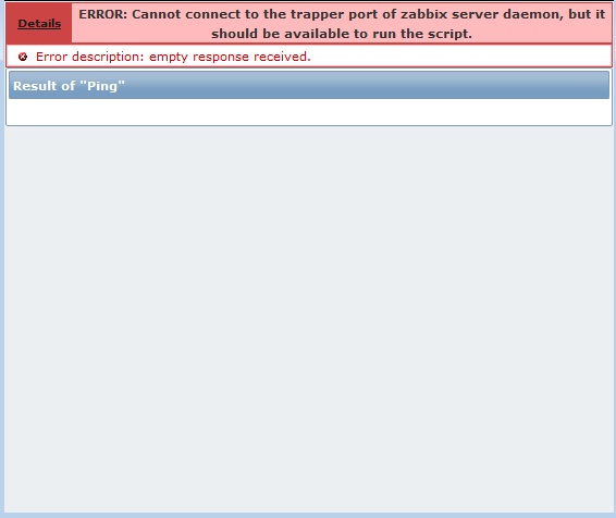

    Tengo todo ya configurado y monitoreado, pero en el momento de dar clic en el ping sobre el servidor que estoy monitoreando sale una ventana con:
    I have everything configured and monitored, but when clicking on the ping on the server I get a window monitoring
    ERROR: Cannot connect to the trapper port of zabbix server daemon, but it should be available to run the script.

    Is it possible, that the script is configured to be executed on the agent and there is either a Zabbix-Proxy in between or the agent has passive checks disabled?
    What do you see if you click on 'Details' next to the error message?
    • CATSOFT
      • Feb 2013
      Error Description
      In consecuence, this error description is following.
      Error description: empty response received.

          Does the host of the Zabbix frontend have direct access to the host (and port) of the Zabbix server?
