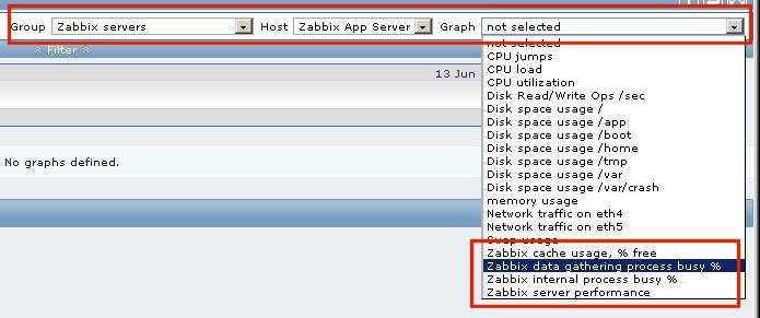

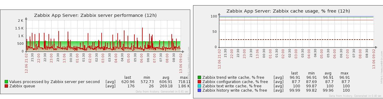

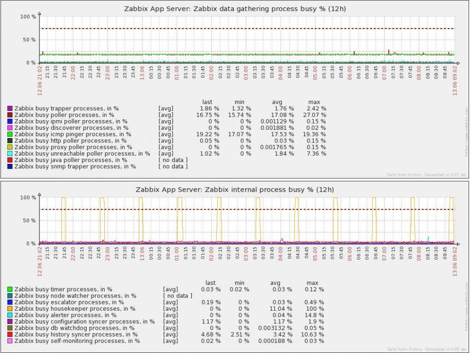

        How many hosts are you monitoring? Have you looked at your graphs for the Zabbix internal checks that provide information on performance of the various Zabbix server processes?
        I personally build a screen for my Zabbix App server, Zabbix DB server and my Zabbix proxy servers using these graphs. See my screenshots below for my App server. This information can guide you in dynamically tuning your Zabbix server parameters and give you insight into how well it is functioning at any given time.

                Groups are named whatever anybody wants to name them. I am just basically showing you how to get to those graphs. Your groups can certainly be named differently. Look for whatever group your Zabbix server is in.
                If those graphs aren't there for your Zabbix server, it may simply be that you don't have that template attached to your Zabbix server. The template in question is Template App Zabbix Server.
