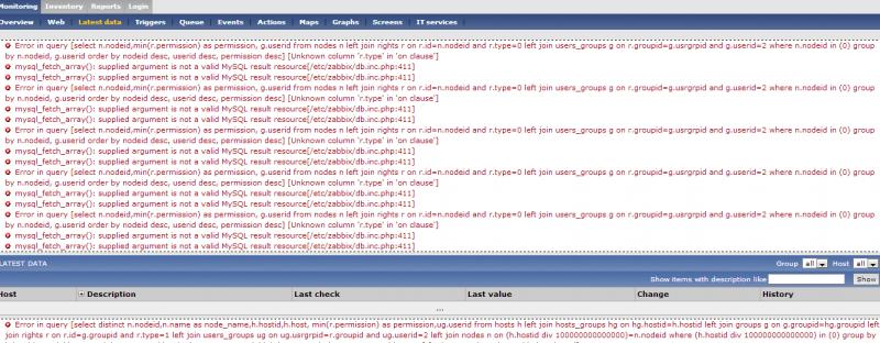

when i loggin my zabbix in web interface, I got error
  • sooraj
    • Jun 2013
    Hello all,
    When in use the url of ZABBIX "localhost/zabbix", I go the following error attached with this post.
    I am using zabbix 1.8.1 version and mysql 5.0.95.
    Please help me out this.
    Thanks in advance
    Sooraj N

    • tchjts1
      • May 2008
      • 1605
      Unless there is a reason you need to be on 1.8.1 - I would get off of that.
      There are much newer releases available with improved functionality. 2.0.6 is the latest. if you need to stay within the 1.8.x version, then 1.8.16 is available.
      Generally the x.x.1 versions tend to be a bit buggy. I try to wait until at least the x.x.4 to implement.
      But if you need to stay on that version... how did you do the install? Through packages or did you compile your own from source?
      What platform are you installing on?
