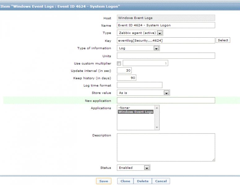

      That helped alot actually!
      I was able to read a specific event ID.
      But I'm still trying to create a trigger for the time to only notify if the event contains spcific items:
      "Logon Type: 10". or
      "A session was reconnected to a Window Station."
      That, I can't figure out.
      I have attached my actual Item.

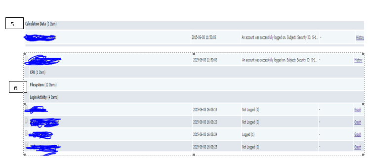

                          This is what I did to check login on and login off on user and display a nice view on screem.
                          Image 1: I create a event log item: check Regular Expresion "@CustomUsername", and Event id 4624, and 4647, logon and logoff
                          Image 2: show regular expressions, matching username in this case CustomUsername, and shold match logon type 10, type 2 and logoff so, I make sure that is the correct, from the correct user. Spaces are take in cosideration, so I copy from event viewer : Logon Type: 10, and all other, Log on type 10 is from remote destop client, logon type 2 is directly into the pc, so correct espacing is set.
                          Image 3: I created a Calculated Item and look for data from the Data customusername Item, and specially search if data is logoff, if match result is 1, but is a sustract so 1-1 (cuz expresion if loggin off is the last is iqual to 1) result in 0. If log on result in this exp is 0 so 1-0 =1.
                          Image 4: Show value User LogOn Status, is 0 Not logged and 1 Logged.
                          Image 5: show how users is pull from event viewer when logged off and log on, check that it substract the data. So I with the calculated item i display nicely how show Image Number 6. Show me if user is log on or log off.
                          Take in mind. I created one calculation data (one Item) from every user, and one login activity from every user.
