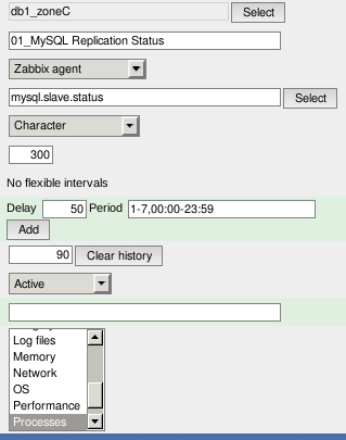

    On our Zabbix 1.8.10, we have a client that needs a simple method of checking for MySQL (5.x) Replication status and I wasn't overly convinced I needed someone else's perl or bash script to do so, so I created a UserParameter on the target host using
    UserParameter=mysql.slave.status,mysql -e "show slave status\G;" | grep Slave_SQL_Running | awk '{print $2}'
    and this works as expected.
    And double-checking my work from the zbx_server,
    /usr/local/bin/zabbix_get -s IP -k mysql.slave.status
    I get the Expected 'No' response.

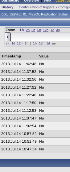

    The issue seems to be my trigger. When I created it, it fired an alert every 60s for 5 minutes and I received those with this body:
    replication status on db1_zoneC: PROBLEM Last Value: No
    Great. Looks like it is correct. Then the Boss says "change the interval to every 2, no 6 hours" so I changed the interval to 21600, this is where the weirdness starts.
    We got alerts...
    Subject: db1_zoneC MySQL Replication Status: OK - Recovered
    MySQL Replication Status on db1_zoneC: OK Last Value: No
    Now, I am pretty certain that No means No and it is not "Recovered".

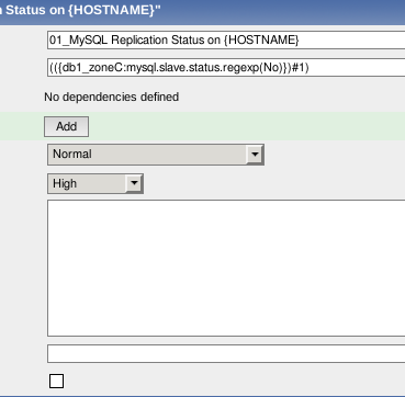

    The trigger I am worried about is this:
    (({db1_zoneC:mysql.slave.status.regexp(No)})#1)
    Attached are the Item, Trigger and Latest Data screenshots.
    I have since set the interval back to 300s and have not received any alerts.
    still gets the Expected 'No' response.
    Nothing has changed on the underlying zabbix server or the mail host that processes the alerts.
    I did just now try to change it from Character to Text but this change doesn't return any data and history is now blank. I changed it back and a screen full of Nos.

  • Colttt
    Zabbix Certified Specialist
    • Mar 2009
    • 878
    please try "No"
    (({db1_zoneC:mysql.slave.status.regexp("No")})#1)
    Debian-User
    Sorry for my bad english
    • cirrhus9.com
      • Feb 2012
      • 58
      Colttt:
      I did as you suggested. No change.
      Thank you,No
      JJ
      Edit: Well, I just got this:
      Subject: db1_zoneC 01_MySQL Replication Status: PROBLEM
      01_MySQL Replication Status on db1_zoneC: PROBLEM Last Value: Yes
      Puzzled.
      Edit: So I changed the trigger to
       (({db1_zoneC:mysql.slave.status.regexp("No")})#0)
      and we got a Recovered email with "Last Value: Yes" in it.
