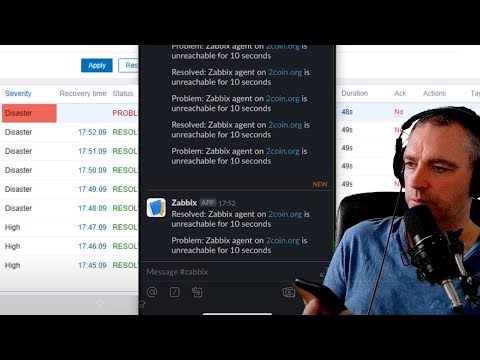

            • seanwasere
              • May 2012
              • 12
              In this video I demonstrate Hysterisis, Manual Close, and Alert severity to manage the amount of alerts I get.
