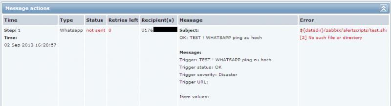

    Hello i have a problem my simple script waont be executed on a action
    in events they still is the message "fails"
    aim using zabbix Zabbix Appliance 2.0.6

    What is the reason for failing according to Event details in frontend?
    Do you already have inspected the zabbix_server.log file for errors?

      thx that you pointed me to the event details!
      Error:
      ${datadir}/zabbix/alertscripts/test.sh: [2] No such file or directory
