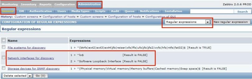

    Network Interface LLD it doesn't discover the loopback interface
    I noticed my Zabbix install it doesnt discover the "lo" interface. I am using Zabbix 2.0.8 and on all servers seens "lo" interface is not discovered.
    Any idea what I can do to bring "back" the lo interface ? The filter from LLD has this default values:
    Filter: {#IFNAME}
    Regex: @Network interfaces for discovery

    Have a look at the regular expressions. Most likely you will find a rule
    6 ยป ^lo$ [Result is FALSE
    Just disable that one and wait until the LLD kicks in again (or temporary decrease the interval).

      If you are unsure as where to find that, this screenshot should help.

        Thanks!
        I wasn't aware about that setting.
