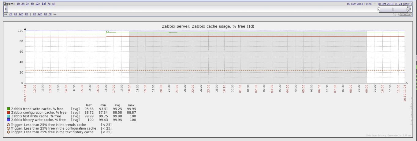

zabbix cache usage: i42.tinypic.com/2j1uc8w[dot]jpg

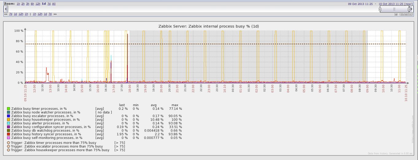

zabbix internal processes: i39.tinypic.com/1tkdgj[dot]jpg

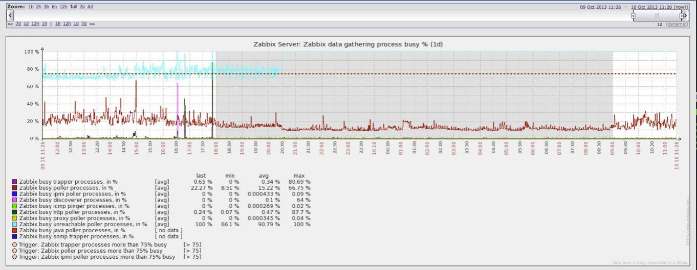

zabbix data gathering: i41.tinypic[dot]com/30mvlhw.jpg

So what I see in your graphs.... your unreachable pollers were being hammered for about 5 hours straight. Were your servers actually unreachable during that time? That would explain your queue being very high.
Otherwise, your settings are not that bad. These settings are all in zabbix_server.conf. Your cache settings look good. If it were me, I would increase my StartPollers= and UnreachablePollers= a little bit, maybe add 20/5 respectively. I would also bump up my Timeout= to 10, if you still have it at the default of 3.

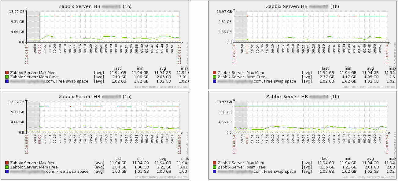

Thanks, things seem to be better now that I changed the swappiness on the server to 0 so that it only swaps as a last resort and applied the configuration tweaks you suggested. However one problem still remains, if you look at my attached screenshot you'll see that some graphs are randomly getting breaks in them. The graphs are using data obtained from scripts the server is set to run as items and the scripts should be fine. The graphs weren't a issue until we finished adding all our servers and monitoring items, now it seems like the server is too busy to maintain a steady stream of the data the graphs depend on? Anything to tweak to make the data come in more reliably? Thanks.Comment
