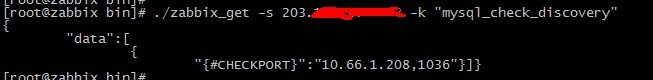

    hello,i'm new in zabbix.
    I'm now configuration zabbix LLD(Low-level discovery) to autoadd port monitoring.
    and there is the JSON return
    it's looks like ok
    "data":[
    "{#CHECKPORT}":"10.66.1.208,1090"},
    but after i add a item it's something the matter
    i use net.tcp.port[ip,port]
    after LLD discovery
    it's add a item like this
    net.tcp.port["10.66.1.208,1090"]
    and the two " " how can i take out it?
    thanks

    You need to send TWO LLD macros, for example,
    {"data":[
    { "{#CHECKIP}":"10.66.1.208", "{#CHECKPORT}":"1090" },
    and in item you need to use: net.tcp.port["{#CHECKIP},{#CHECKPORT}"]
    It's because there are quotes in your item example, and zabbix use all that string: "10.66.1.208,1090" as ONE parameter.
