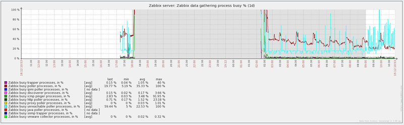

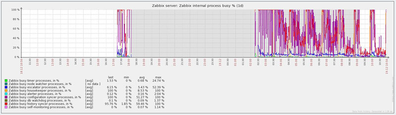

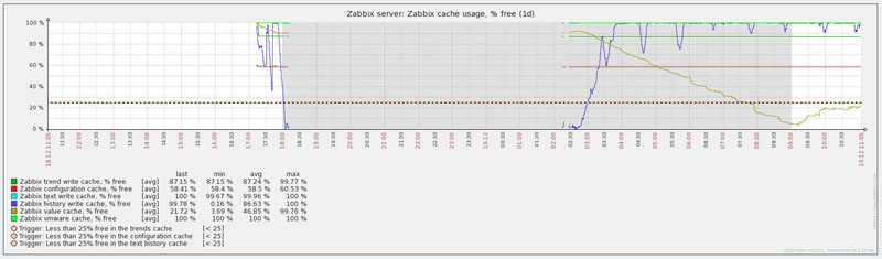

            So I can try and be more specific on our problems, we are finding very long load times when initially opening Zabbix (we use LDAP, but are not experiencing any login issues). Also when clicking any link we often have to wait 20 - 30 seconds for the page to load. Previously this would be almost instantaneous.
            We hadn't initially considered PHP, and so will do some forum research before requesting any further help
            Finally I have attached the performance graphs from our server. Please note we had been running a Table Optimization process overnight, as it had been recommended by the MySQL tuner.
            I hope this answers all the questions, and thank you for all your help so far.
