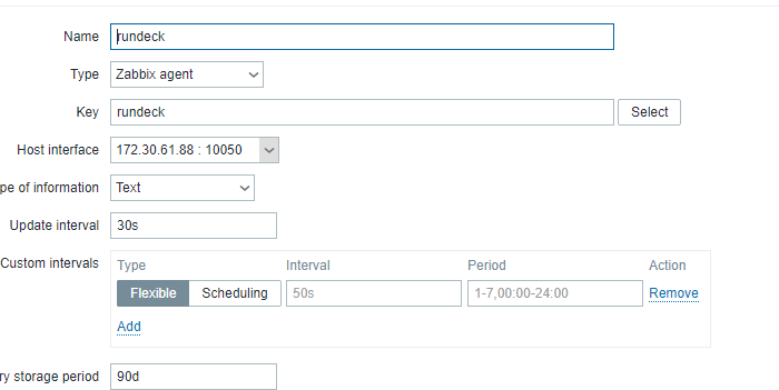

    Zabbix trigger based on string output
     #!/bin/bash   curl -s -H "Accept: application/json" -X GET "http://172.30.61.88:4440/api/20/project/demo/executions?authtoken=ZP9znayUp3Ktp26uQjSQGnEfTzDvqPDA"  | python -m json.tool > 1.json  jq -r '.|[.executions[] | select(.job.name != null)]  | sort_by(.id)  | reverse  | .[0]  | [.status, .job.name, ."date-ended".date] | @csv' 1.json > 1.csv  sed 's/,/ /g' 1.csv>st.txt while read status name date; do case "$status" in "\"aborted\"") echo -1 ;;  "\"failed\"") echo -1 +$name ;;  "\"succeeded\"") echo 0 + $name ;; *) echo 0 + $name esac exit 0 done<st.txt
    I have script which monitors rundeck jobs and returns job state with job name, is it possible to add script output ($name) to trigger so i can see job name in alert

    Hello, dragan979!
    Use {ITEM.VALUE} in trigger name field
    If you have multiple items in trigger definition then you need to use {ITEM.VALUE1}, {ITEM.VALUE2}, ..
    Regards,
    Aigars
    • dragan979
      • Apr 2018
      • 49
      thanks aigars.kadikis, my item is named rundeck, so in this case i need to add {rundeck.VALUE} ?, can't try it now, only in the evening
      • aigars.kadikis
        • Mar 2018
        • 208
        No.
        You need to use just exact {ITEM.VALUE} or even better {ITEM.VALUE1}
        Explanation:
        Every item value (custom or built-in) which are used in trigger expression gets automatically converted to hard coded variable/macro named {ITEM.VALUE}.
        Once there is more than one item used in trigger expression then these variables get automatically numbered like:
        {ITEM.VALUE1}
        {ITEM.VALUE2}
        Regards,
        Aigars
        • dragan979
          • Apr 2018
          • 49
          yes, this is it !, just as i wanted !!, thanks !!1
