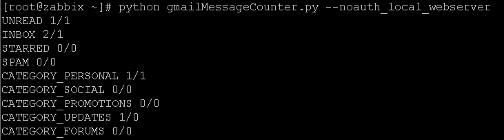

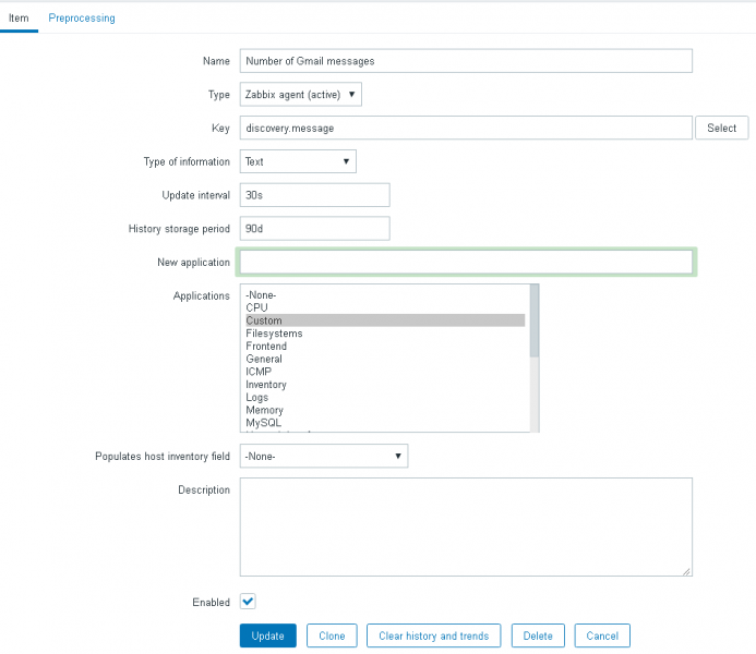

    I have monitor gmail using python script (image 1.png) and I want to create an item for this? I do add the script under User Parameter as shown in image 2.png.
    Can someone help me?
    Thanks.

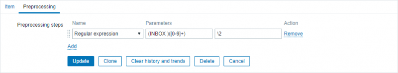

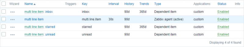

    You have to create one item with type text and then create multiple preprocessing items with regular expression like:
    (INBOX )([0-9]+) and extract second group:

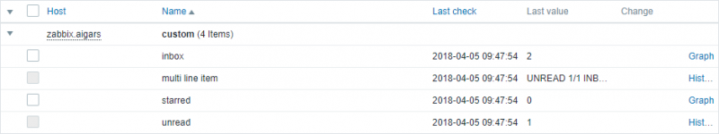

    and you got data captured out:
    Hope it helps

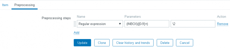

    Hi aigars,
    Thank you for your kind reply, but I can't get any result. Could you point any mistake on this (as attached image)?
    Thanks.

      Hi, Mun!
      Welcome back!
      Please do not create preprocessing in the main item. Leave it untouched.
      Preprocessing goes only in dependent items this time.

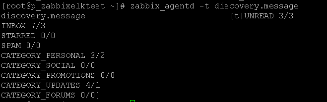

      Test the key
      zabbix_agentd -t discovery.message
      Test key from 'zabbix' users perspective:
      sudo -H -u zabbix bash -c 'zabbix_agentd -t discovery.message'
