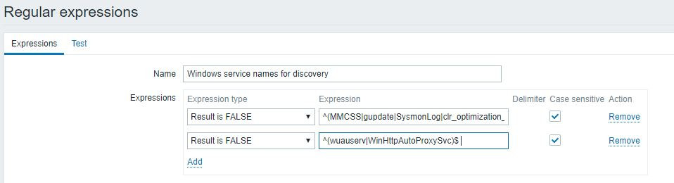

      I am going to base my answer assuming you are using the default Windows service discovery rule and have not changed any of the config.
      If you look at the regular expression: Windows service names for discovery (Administration > General > Regular expressions)
      You will see an example already. By default the discovery process excludes some services - each service is separated by a "|". You could add additional service names to that string or you can create additional expressions types. You could even create a whole new regular expression rule and tie it back into the discovery rule. To keep things simple, I would create an additional expression in the default "Windows service names for discovery" regular expression to avoid changing the default regular regular expression string.
      The Expression type would be: Result is FALSE
      The Expression would be: ^(serviceName)$ - for multiple services: ^(serviceName1|serviceName3|serviceName3)$
      In other words, you would do this: ^(wuauserv|WinHttpAutoProxySvc)$
      Hope this helps - good luck!
