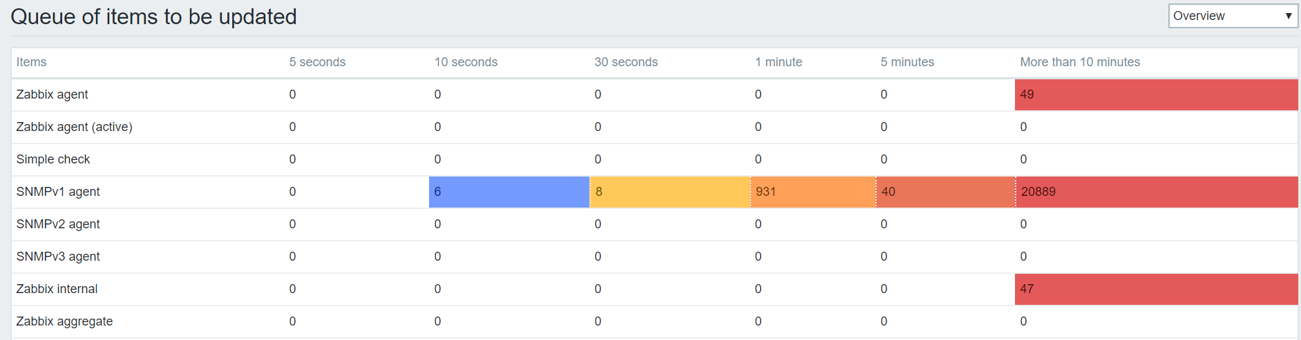

      I am experiencing the same problem where items for all my hosts in the zabbix server stopped being polled. What could be the problem?
