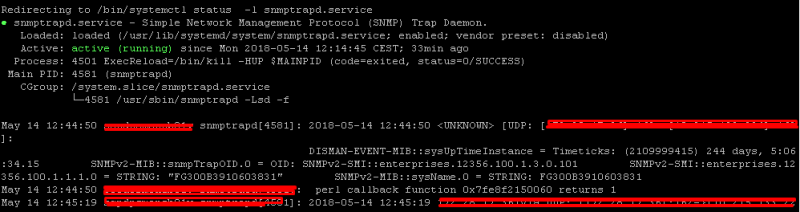

    Hi, I have the following problem about the zabbix TRAPS. I am able to receive the traps on my server since I visualize them in the log. But I am not able to pick up the traps through the zabbix item or with the snmptrap.fallback item, it is not able to pick up the log traps.
    The zabbix_trap_receiver.pl script in its execution presents the error
    Undefined subroutine & NetSNMP :: TrapReceiver :: register and if I define the routine it presents the error,
    Can not locate NetSNMP / TrapReceiver / register.pm in @INC (@INC contains: / usr / local / lib64 / perl5 / usr / local / share / perl5 / usr / lib64 / perl5 / vendor_perl / usr / share / perl5 / vendor_perl / usr / lib64 / perl5 / usr / share / perl5.) at ./receiver.pl line 56 BEGIN failed - compilation aborted at ./receiver.pl line 56.
    The truth is that at this point I am stuck and I can not move forward. The only thing I need is that zabbix pick up the traps through the items, I have also rapsado the documentation offical following the steps but still I have not been able.

      Thanks,but it's already installe.
      snmptrapd.service if it shows the traps Regards.

          The question remains the same, because snmptrap.fallback does not collect the traps or the specific items?.
          Everything seems to be working less catching traps.
          I have tried several configurations as well as re-installing the SNMP components without having any results.
          Thank you very much for the help.Regards
