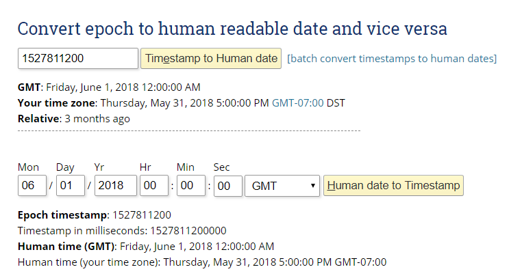

          To quickly fix this I would suggest updating the manual SQL entries (mentioned again below) by adding the CREATE TABLE and CREATE INDEX based for each month using the https://www.epochconverter.com/.
          You need to take the epoch timestamp from the 1st of each month; e.g. 1st of August, 2018 00:00:00 through 1st of September, 2018 00:00:00.
          Here is a screenshot example.
          Below is the SQL query examples for June 2018, July 2018, August 2018 and September 2018:
