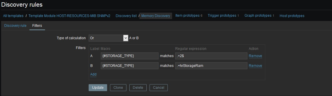

    Are these 6000 items mainly in a supported state? Are you able to remove one of them manually? What Applications category has assigned for the most of these 6000 items?
    3. There are three discovery rules in 'Template Module HOST-RESOURCES-MIB SNMPv2' - storage, memory, CPU. You need to work with Filter section and create some exclusion rules to decrease the item count in one of your servers.
    After you set new exclusion filters then please set temporary 'keep lost resource period' to 0.
    and decrease your discovery rule 'Update interval' (for example to 10m) just to take faster effect.
    Can you clarify which discovery rule has generated so many items in your situation?
    2. I hope the third point will solve the second one.

      It has added the Template - HOST-RESOURCES-MIB SNMPv2, the Application Memory and teh Memory Discovery Rule and the Discovery items in it. All was preinstalled in Zabbix.
      The filters are set as it was created in Zabbix:
      Click image for larger versionName:	Filters.jpgViews:	1Size:	54.9 KBID:	359174
      Where should I set the 'keep lost resource period'?
      Yes, as I wrote above it is the Memory Discovery rule. I dont know hy it has find so many memories, when in older version when I had installed it was OK and in this devices are not so many memories ...

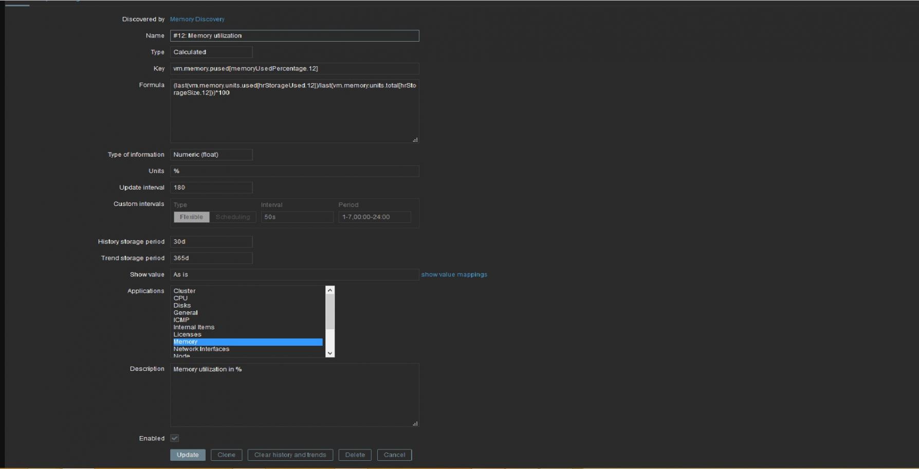

          Hi Aigars,
          here are the screen shots:
          Click image for larger versionName:	Items.jpgViews:	1Size:	80.4 KBID:	359179
          Click image for larger versionName:	Item-settings.jpgViews:	1Size:	68.8 KBID:	359180

            Please list the STORAGE_TYPE on the host where you have a lot of items:

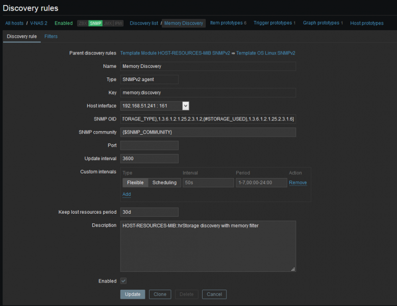

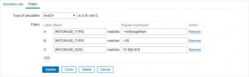

                          • Alfista
                            • Mar 2017
                            • 136
                            #15
                            Of course.
                            In the Discovery rule i have changed the SNMP OID as you sent me:
                            discovery[{#SNMPVALUE},1.3.6.1.2.1.25.2.3.1.3,{#ALLOC_UNITS},1.3.6.1.2.1.25.2.3.1.4,{#STORAGE_TYPE},1.3.6.1.2.1.25.2.3.1.2,{#STORAGE_USED},1.3.6.1.2.1.25.2.3.1.6]
                            And here are the screen shots:
                            Click image for larger version  Name:	Discovery.png Views:	1 Size:	212.9 KB ID:	359439
                            Click image for larger version  Name:	Filter.png Views:	1 Size:	78.8 KB ID:	359440
                            I don't fully understand it. On other Linux PC it works correctly, only this one not.
