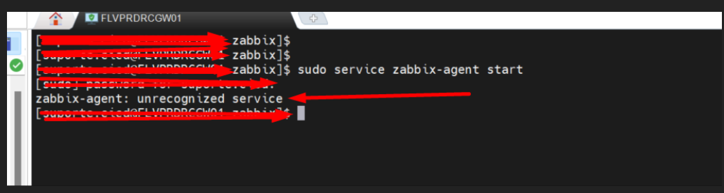

        Can you help me please, I had a similar error, even following the spaces here... my zabbix agent returns as unknown.

          Hi Malebo,
          what platform are you using? Have you installed Zabbix agent? how did you install it?​
