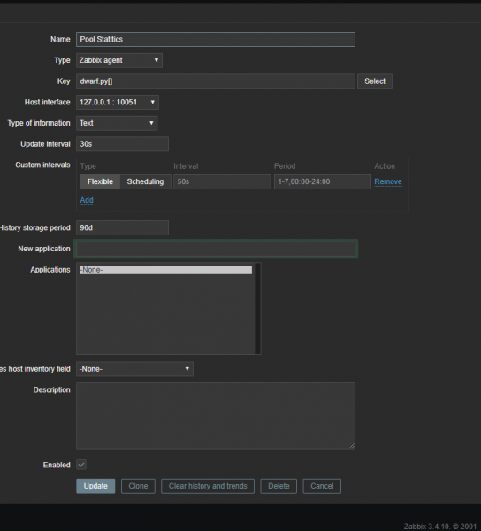

      I'm at least getting an error message now (shown below):
      Received empty response from Zabbix Agent at [127.0.0.1]. Assuming that agent dropped connection because of access permissions.

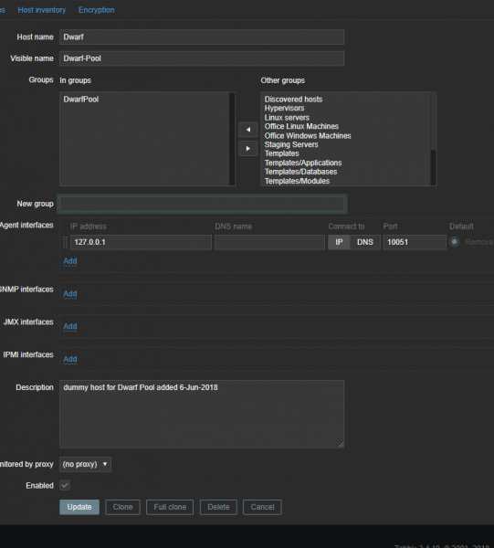

      I did a little research and found some really old posts mentions zabbix_agentd.conf needs to include 127.0.0.1 and the default should be "Zabbix Server". Is this the case?
      I have also attached screen shots of my setup. Sorry for all the rookie questions, I do really appreciate the help.

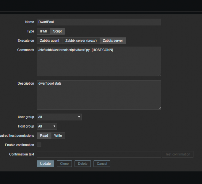

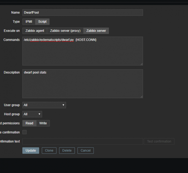

            3. Go to the front end of the Zabbix web GUI and navigate to the Administration -> scripts tab and select create new script. See screen shot below for setup details

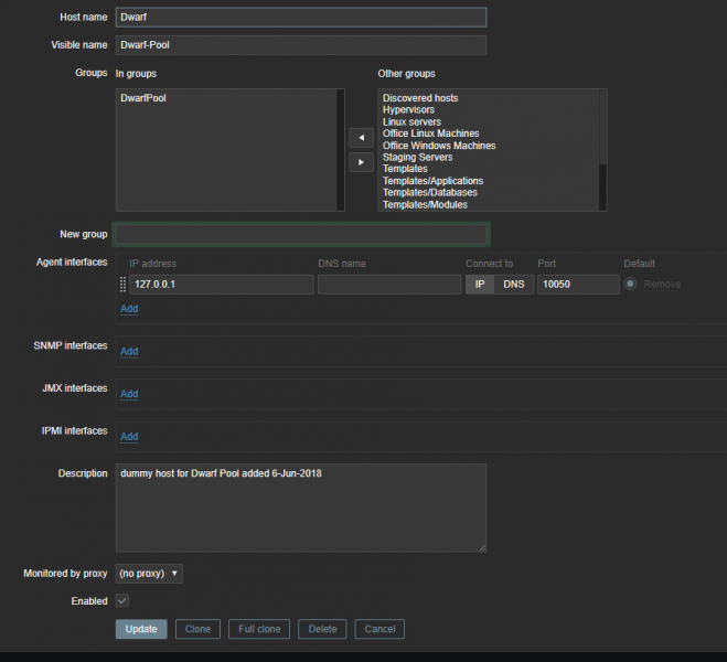

        2. Create a dummy host has shown in the screen shot below:

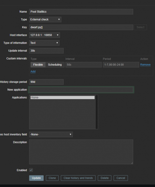

        4. Create the item accordingly (as shown below):
