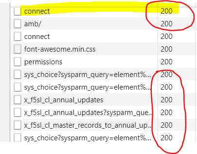

    I'm new to Zabbix and hoping someone may assist. I have a web scenario running successfully abut the page load times are incorrect and the find text errors. I've tracked it down to when the page loads I receive a 200 response very quickly when i inspect the page using chrome. But there is still data loading on the page and once that is complete i see the text I am looking for. Is there any way I can script to wait until all components of the page are loaded????

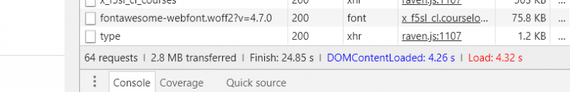

      Hi kernbug, thanks for that. The login steps work fine. I am abl to validate this when looking at the application server and can see a successful login. so all the post transactions are working fine. Where it is not workin as expected is when i navigate to a page that i know is taking about 12 seconds to render and display. When I inspect this activity in chrome is see the following.

      I think that the step is seeing the first connect and reporting on that. What I want is to wait until the page is fully loaded and I can report on the real response times. This is where I'm stuck.

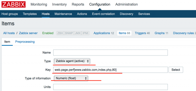

        Also you can use Zabbix Agent with web.page.perf[host,<path>,<port>] - "Loading time of full web page (in seconds)".

            This items measures load time between Zabbix agent host and web server. If Zabbix Server is monitored by Zabbix Agent you can add item to Zabbix Server host like this web.page.perf[www.zabbix.com,index.php,80].

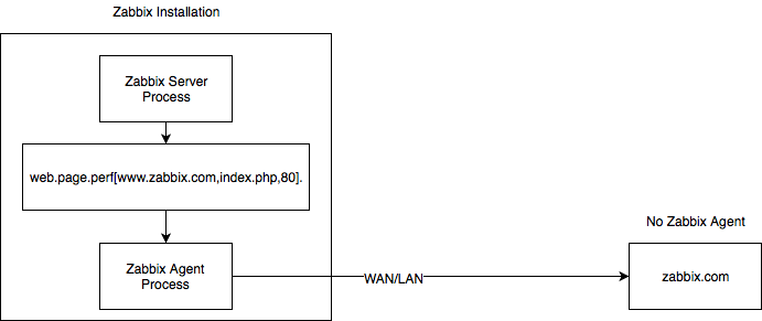

                  oh. ok. then i am still stuck with measuring the load time of the web page I am trying to measure. This site is on another host that does not have an agent installed. any suggestions for this?

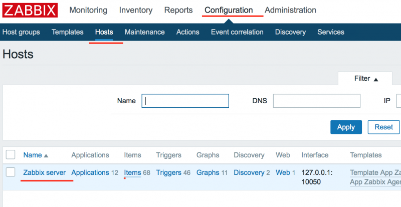

                    "1 minute" schema (please don't laugh at me), you need to setup one active check on Zabbix Server (with installed Zabbix Agent on it), no changes needed on the remote web server:
