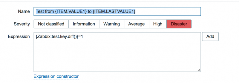

                    • kernbug
                      • Feb 2013
                      • 329
                      Originally posted by fdavidcn
                      Hi kernbug, i was try your config without success
                      Always get the same value. I was try following functions without lucky:
                      avg
                      last
                      diff
                      prev
                      Thanks!
Name:	Снимок экрана 2018-06-20 в 12.44.32.png
                      • fdavidcn
                        • Jun 2018
                        • 19
                        Hi Kern!
                        I was write identical as you show me but the value of MACRO are always the same. I was try in the same trigger to put in name field {ITEM.VALUE}, {ITEM.VALUE1}, {ITEM.VALUE2}, {ITEM.LASTVALUE}, {ITEM.LASTVALUE1}, {ITEM.LASTVALUE2} but all these MACROS have same value
                        Thanks!
