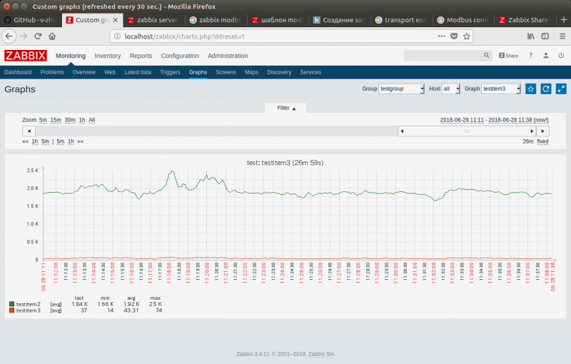

                    Finaly I've got modbus working. Now need to work on graphs..
                    Thank's.
                    Solved it by uninstalling debian and installing ubuntu. From ubuntu remove mariadb and add mysql.
