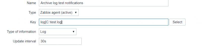

    Hello everyone,
    I have problem with monitoring log file on windows. For first testing i just need some basic log file monitoring without any filters, so i tried to use log[C:\test.log], item is not unsupported or any other error but it doesn't get any value. and i set up log at agent to 4 so i can see more info, but i don't see anything about this item. Can anyone help please? There is screenshot: Click image for larger version

    Hello
    Specify search string in the item parameter, here is the example: https://www.zabbix.com/documentation...ypes/log_items
    log[C:\super.log,search_string]

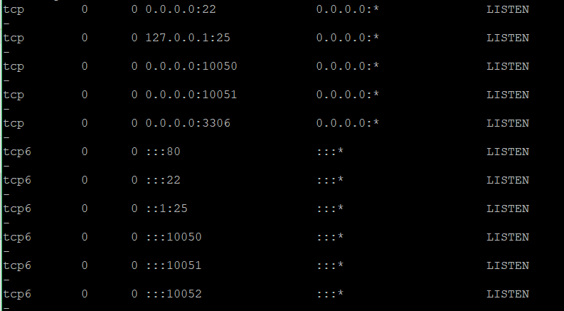

              I tried nc but on that server is no such program system is centos, so i tried netstat -tulpn and here is result: Click image for larger version

                Hm, not the result I expected, my mistake.
                Execute on Zabbix Server:
                iptables -L -x -v -n --line-numbers
                ip a

                    Execute:
                    iptables -I IN_public_allow 4 -p tcp --dport 10051 -j ACCEPT
                    After this check from Windows machine:
                    telnet 192.168.10.191 10051

                      You are BEST! Thanks, it solved problem :-)

                        Don't forget to make persistent changes of your firewall on Zabbix Server!
