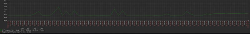

      The latency is over the threshold for over an hour:

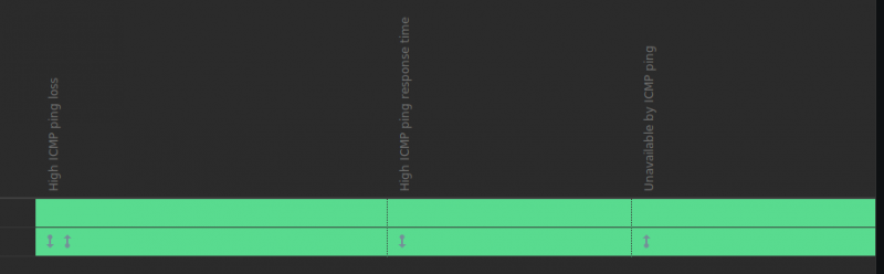

      and I can see the WARN on the graph itself but I do not see it on Dashboard in the Problems area.
      I added a Trigger Overview to the dashboard and the triggers are all green there:
      Above you can see two almost identical triggers from "Template Module ICMP Ping", the upper ones are from full-cloned template with all trigger dependency deleted for testing purposes.
