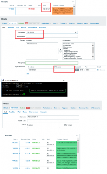

    Use of Hostname instead of IP to identify hosts
    So continuing on my SNMP journey, is there a way to populate the HOSTNAME field in the host tab with the hostname (taken from SNMP) rather than the IP that was discovered? As can be seen from the series of screenshots attached, the IP is used in the Problem widget which makes it hard to identify the host immediately. The only way to make it display the HOSTNAME is to populate the Host Name field in the host tab. But when using discovery with SNMP (we can't install agents on these devices), it uses the IP instead. I've already tried putting the SNMP sysName.0 OID as part of the checks during discovery and even selected it as the uniqueness criteria but no go.

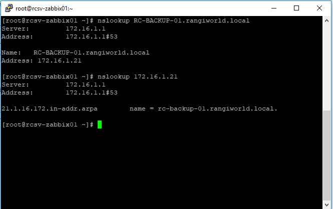

        OK, I've checked and the Zabbix server can resolve the IP to a hostname. As an experiment, a server that was showing with the hostname in the Problems widget was edited to only contain the IP address and as soon as I did that, the IP address showed up instead of the hostname in the Problems widget. This leads me to believe that when creating the host record, we MUST put the real hostname in the Host Name field. So I am back to my original question ... if we are using SNMP to discover these hosts, how do we auto-populate the Host Name field from the SNMP OID?

              Originally posted by Linwood
              Note when they say DNS set up, be sure that the REVERSE zones (PTR zones) are also set up before you discover a host.
              My apologies if the screenshots above were too small but yes, I have checked both forward and reverse are working ... anyway, thanks for confirming that it should be working without me having to manually assign it (that's good news to me given that we've over 100+ nodes to monitor and only me to add them :-) having to go edit each host record was not very appealing). I just need to find what's wrong in my config that's preventing it. At least now with your help it's been narrowed down to just the DNS.
