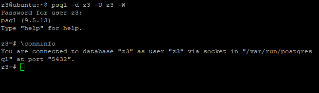

    Can you connect to the database from the console?
    • N.S
      • Jul 2018
      Hi, yes. Here's a caption that shows the connection:
