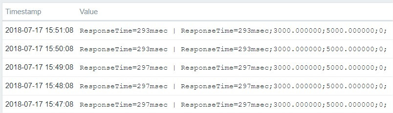

    I am using Zabbix 3.4 with an external tool (Nagios SAP CCMS Plugin) that collects via an external check item specific informations from an SAP system. As the script returns a string I need to preprocess it in order to extract only the required value, for example:
    - Script output --> ResponseTime=293msec | ResponseTime=293msec;3000.000000;5000.000000;0;
    - Information needed --> 293
    The script is collecting and returing data correctly:

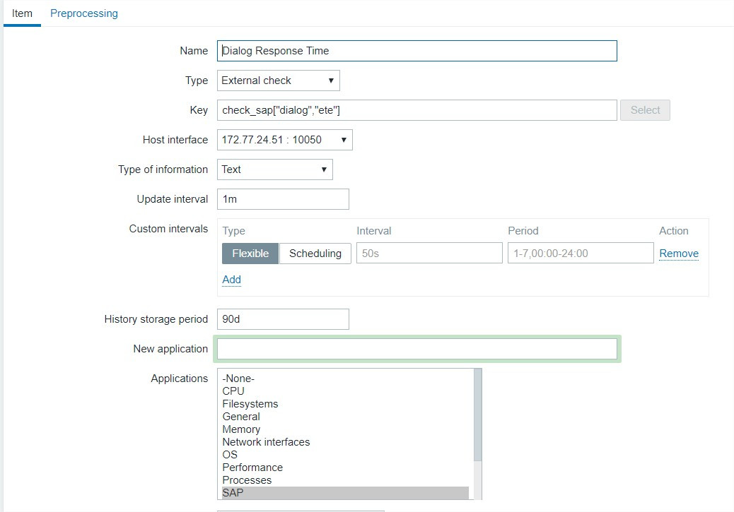

    This is the item configuration (I've tried both Text and Numeric Unsigned in the Type of Information):

    When the collector runs the following error occurs:
    Item preprocessing step #1 failed: cannot perform regular expression match on value "ResponseTime=3msec | ResponseTime=3msec;3000.000000;5000.000000;0;" of type "string": pattern does not match

    Do you have any suggestions or ideas on how could I fix this issue? I'm not sure if the regular expression is wrong or I misunderstood how the preprocessing works. Maybe the is also another way of doing that.
