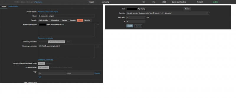

    Well i don't know how exactly to solve your issue.
    however i'll show you how i set up to monitoring "agent.ping" with the trigger
