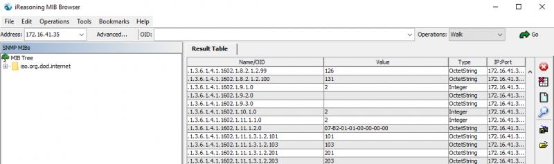

            What I was asking you to do is to do a walk so that you would get something like the one below where it lists down all the OIDs the device supports.

              I did the SNMP walk and snmp get on the proxy to query the device in question. The OIDs I was looking for were not found.
                Then it doesn't support the specific OIDs you were looking for.
                Your next step would be to figure out which OID in the device would give you the same information as the OID you got from the template and change the those OID entries in the template.
