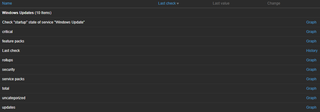

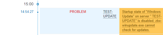

      found this template: https://share.zabbix.com/operating-s...ws-update-v1-0
      I need to fix up this problem
      Click image for larger version  Name:	aaa.png Views:	1 Size:	10.7 KB ID:	364630
      Startup state of "Windows Update" on server " TEST-UPDATE" is disabled, zbx_winupdate.exe cannot check for updates.
      nty
      Value should be lower or 2
      Specifically for startup:
      0 - automatic,
      1 - automatic delayed,
      2 - manual,
      3 - disabled,
      4 - unknown
      https://www.zabbix.com/documentation...agent/win_keys
      I find something weird, I mean , that looks like I need to install zabbix agent as I did because in the setup is required to write sender path.
      But in the availability section it doesn't display zabbix agent avability.

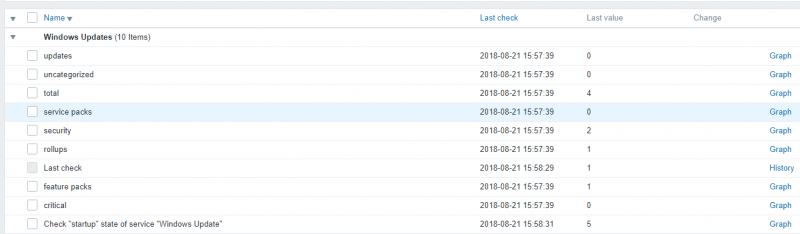

      • RonaldMcDonaldTrump
        • Jan 2018
        • 41
        It's done Click image for larger version

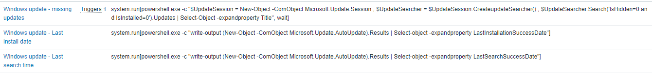

                      • Brambo
                        • Jul 2023
                        • 256
                        I use these items for windows updates check, keep in mind that zabbix agent config must allow system.run and that timeout on missing updates could happen. (agent and server parameter potentially needs to be changed) Click image for larger version
                        In text:
                        system.run[powershell.exe -c "$UpdateSession = New-Object -ComObject Microsoft.Update.Session ; $UpdateSearcher = $UpdateSession.CreateupdateSearcher() ; $UpdateSearcher.Search('IsHidden=0 and IsInstalled=0').Updates | Select-Object -expandproperty Title", wait]
                        system.run[powershell.exe -c "write-output (New-Object -ComObject Microsoft.Update.AutoUpdate).Results | Select-object -expandproperty LastInstallationSuccessDate"]
                        system.run[powershell.exe -c "write-output (New-Object -ComObject Microsoft.Update.AutoUpdate).Results | Select-object -expandproperty LastSearchSuccessDate"]

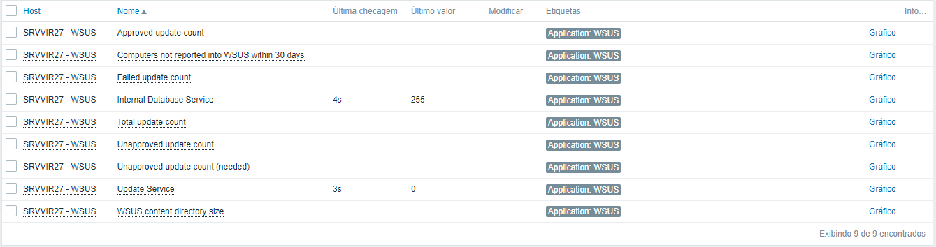

                        • renatobeiriz
                          • Nov 2023
                          • 20
                          for me, not show all stats
