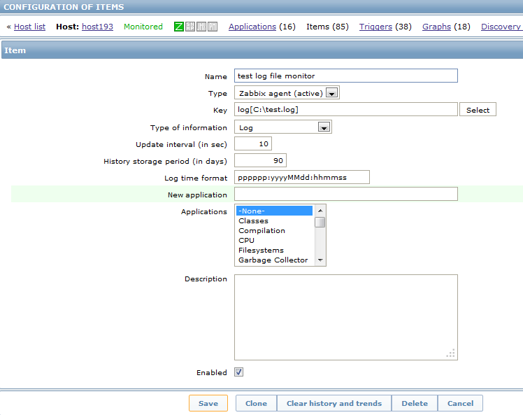

    I'm trying to monitor a log file using Zabbix log file monitoring functionality.
    I'm using Zabbix 2.2.1 delivered on the zabbix appliance on suse.
    Zabbix server is running OK and I'm already monitoring a Win-XP machine using the Windows server template
    I added a new item for log file monitoring as below on the attached file

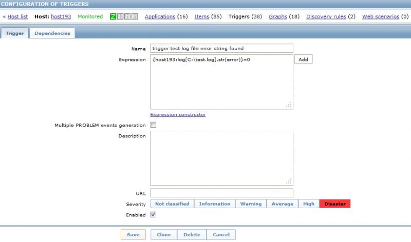

    and added a trigger based on this item if it contains a string "error" as below:
    Now my file does contain the error string and still, by checking Monitoring-Triggers view, the trigger does not get fired up!
    Did I miss anything?

    [B]str 	[/B]1st - string, 2nd - sec or #num 	str, log, text
    	Find string in last (most recent) value.
    	Parameter defines string to find. Case sensitive!
    	Second optional parameter is number of seconds
    	or number of collected values to analyse.
    	In this case more than one value will be processed.
    		Returns:
    		1 - found
    		0 - otherwise
    From this description and you trigger expression I can say that you are looking for any line which NOT included word "error".
    Correct?

      Hi aib,
      You are right it should be =1, and I modified it.
      But I'm still having no event or trigger about it.
