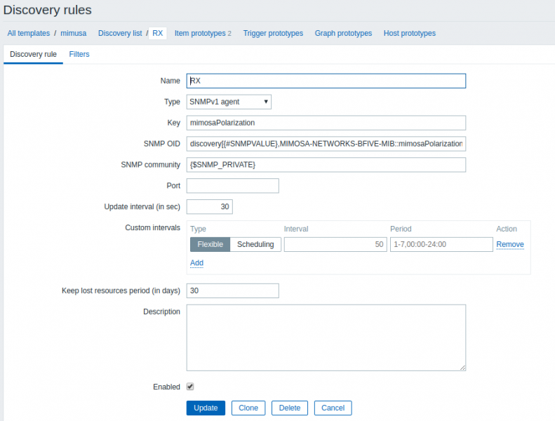

      here is what I did so far:
Name:	Screenshot from 2018-10-10 12-39-48.png

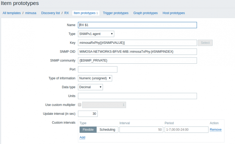

      then created Item prototype
Name:	Screenshot from 2018-10-10 12-40-27.png

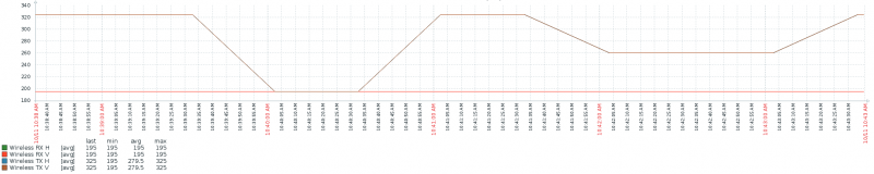

          I already have datarate per second with no problem
Name:	Screenshot from 2018-10-11 10-43-42.png
