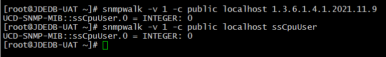

    Hi Atsushi,
    Thanks for your answer .

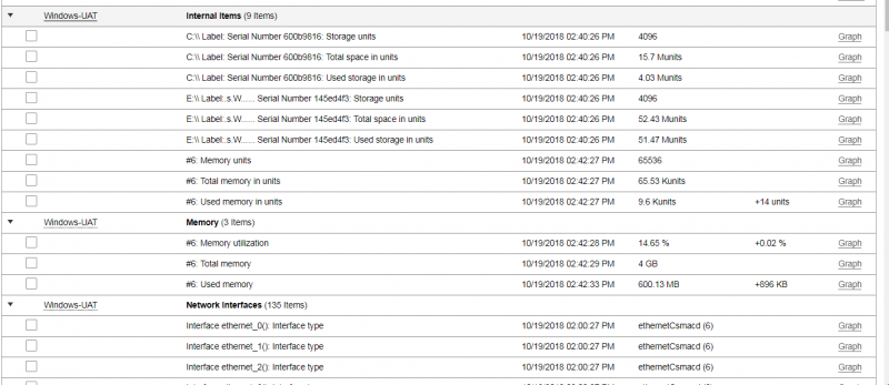

    The target host snmp configure shoulde be fine and discover rule work.(please refer attach file last value of target.png)

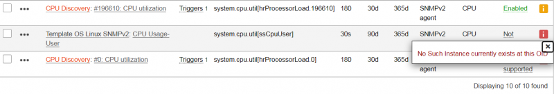

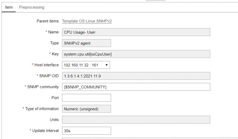

    item of configuration.host list the error 'No Such Instance currently exists at this OID'
    (please refer attach file item error.png,item setting.png and oid check.png)

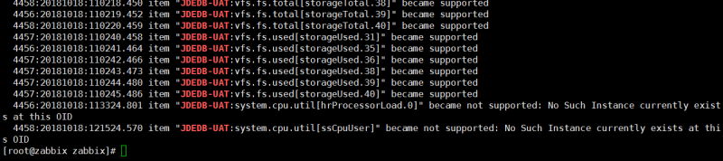

    zabbix server log also show the error . (please refer attach file zabbix server log.png)

      Try using the snmpget command.
      Does it look like the following?
      $ snmpget -v2c -c public localhost 1.3.6.1.4.1.2021.11.9
      UCD-SNMP-MIB::ssCpuUser = No Such Instance currently exists at this OID
      Please properly designate the OID until the end.
      $ snmpget -v2c -c public localhost 1.3.6.1.4.1.2021.11.9.0
      UCD-SNMP-MIB::ssCpuUser.0 = INTEGER: 0

    Hi Atsushi,
    Thanks for your support .
    The value can get normal after designate 0 at end .
