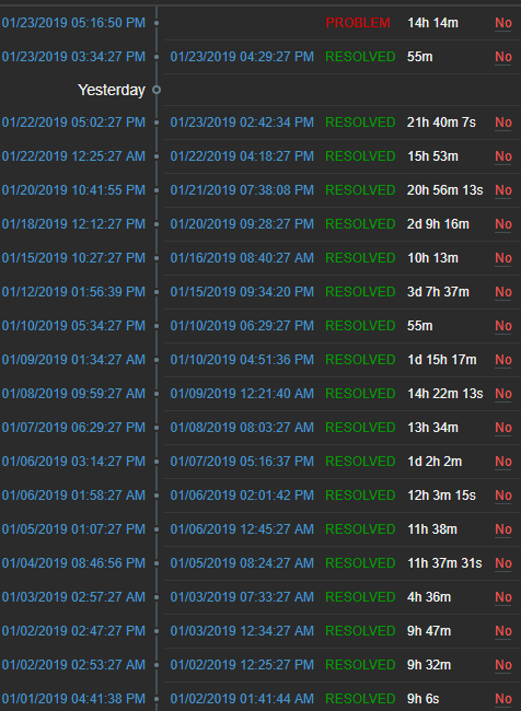

          Click image for larger version  Name:	34a27f510f0ddff1918f80e8e55008b9.png Views:	1 Size:	71.8 KB ID:	372661
          https://i.gyazo.com/14365a394453998a...8bb0d6cfd4.png
          Last edited by rankinc; 24-01-2019, 14:37. Reason: second link showing zabbix graphs, would not upload
