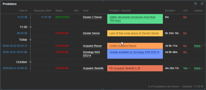

    I'm struggling with API. I need to retrieve via API, the same list of Problem's Tab in the Dashboard.
Name:	2018-10-25 12_30_03-Zabbix docker_ Dashboard.png

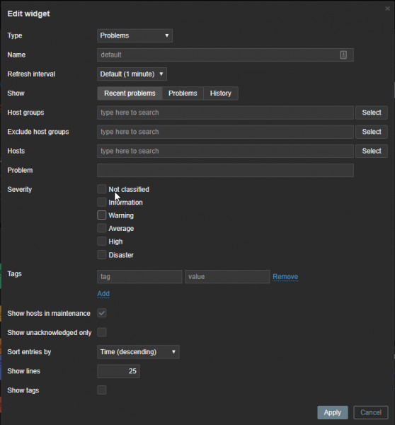

    I setup Dashboard Problem's TAB to show me only lasr 25 Recent problem.
Name:	2018-10-25 12_39_15-Zabbix docker_ Dashboard.png

    But this request return me also trigger on Disable Host that are not shown in Problem's TAB on Dashboard.
    I need some help or suggestion on how filter trigger.get in order to achieve this request.
