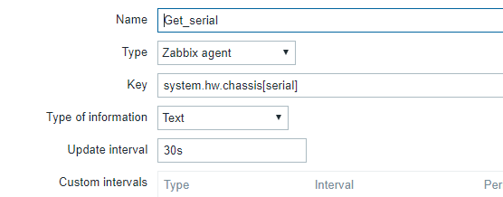

    if i do it in an item (atteched)
    goes "zabbix unsupported"
