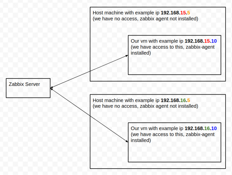

          Thanks, i don't think that's quite what i'm looking for, and we're not using vmware. I've drawn out the current scenario below for more clarity:

          1) We have an auto discovery rule setup to find new vms. So zabbix server has auto detected the vms 192.168.15.10 and 192.168.16.10.
          2) Zabbix has no knowledge of the host machines 192.168.15.5 and 192.168.16.5 since zabbix agent is not installed on the host machine.
          3) New vms are added to zabbix, and the correct templates are attached to the new vms.
          4) We can ping the vms to ensure that it is up.
          5) Therefore there is an entry for the two hosts in zabbix.
          How do we now go about creating a template that can easily be added to each new vm during auto discovery, where the template has an item that pings the host machine on the .5 address, an item that pings the vm on .10 address, and a trigger to say "if host is pingable and vm is not pingable, then trigger an alert"?
          As far as i can tell there's no way of setting up a zabbix item to:
          1) Use the vm ip address
          2) remove .10
          3) Add .5
          4) Now use this new address in the item to ping it
