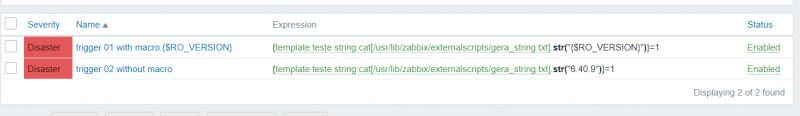

    Hi community,
    I'm trying to create a trigger with a MACRO for RouterOS Version.
    I want to trigger every Router with version diferent from 6.40.9, so I create it.
    Expression = {BR_Template_Mikrotik:system.sw.os.str("{$RO_VERSI ON}")}=1
    MACRO= {$RO_VERSION} => 6.40.9
    and it don't work.
    But if I create direct in the expression with out MACRO works.
    Expression = {BR_Template_Mikrotik:system.sw.os.str("6.40.9")}= 1
    Some one could help me make it work with MACRO?

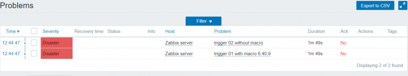

    • flavio.gomes
      • Nov 2018
      I don't know why but I egual the parameter to 0 like {BR_Template_Mikrotik:system.sw.os.str("{$RO_VERSI ON}")}=0 and started to work.
      If I equal to 1 that is the right way the trigger it's allwayes OK don't matter what I put in the MACRO.
