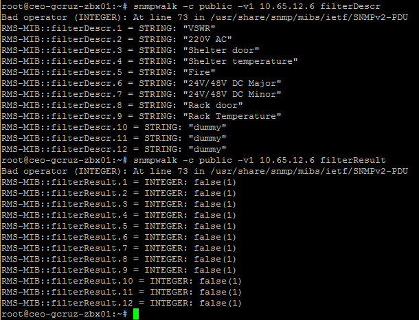

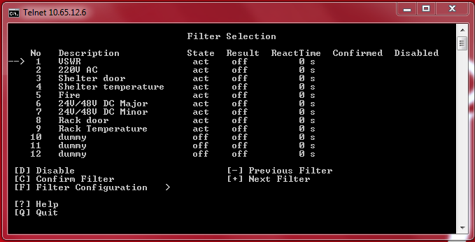

    I need to monitor a computer called RMS (Rack Monitoring System), this equipment has 9 alarms with different sensors connected (called filters) which can be seen in the following image.
    The RMS supports SNMPv1 and after making queries I get results correctly (see images)

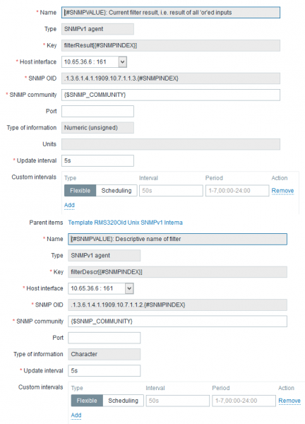

    Later I managed to successfully export the MIB file to the XML template of Zabbix and I created 2 prototypes (see images)
    Here you will see better the two item prototypes that were generated in the template
    What I need is to be able to create trigger prototypes for these two items since the same template will be read by 55 RMS equipment and I do not want to create 9 triggers for each of the 9 alarms (or filters) for the 55 RMS equipment as in the following images
