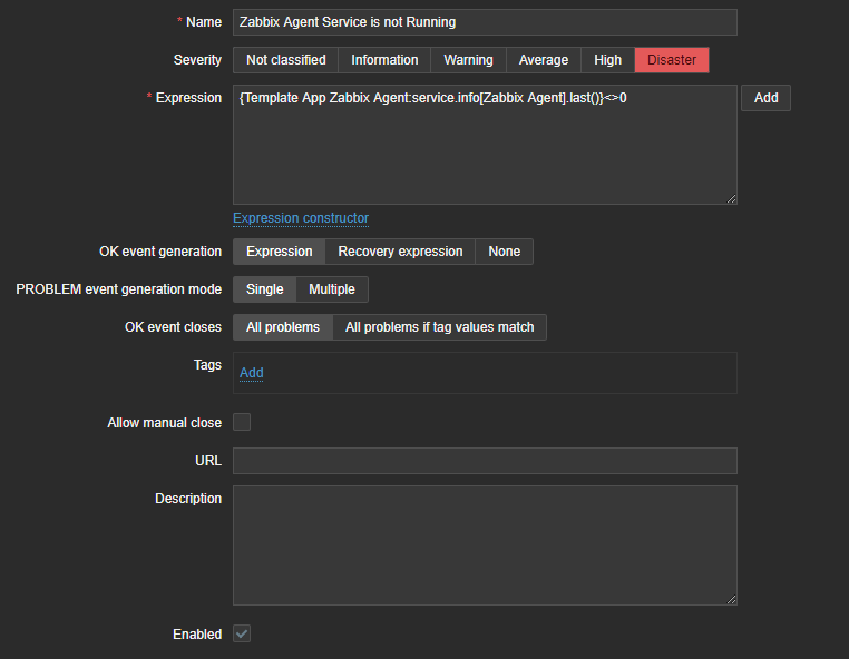

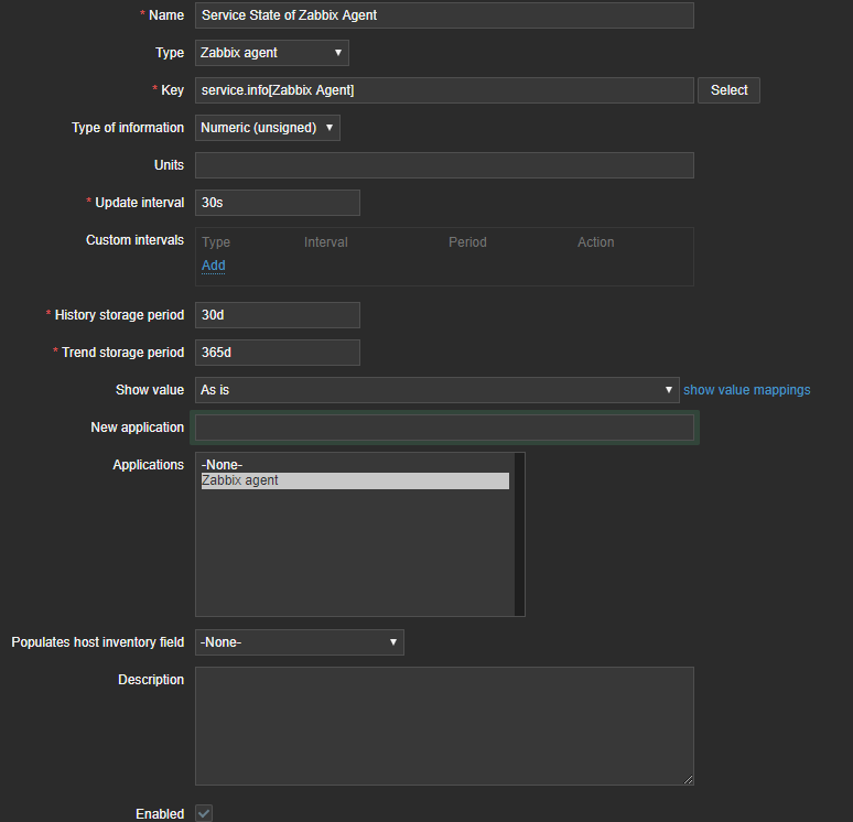

        Hi there again,
        Im posting here, because im having again the same problem. And i think is not needed to create a new thread.
        First of all, let me show u my Item and Trigger configs (pics)
        In the Item config, i've already tested in the "Show value" as "Windows Service State" and "As Is".
        I've stoped "Zabbix Agent" service in a Windows Server and in Hosts page i can see that ZBX is red but in Dashboard is not showing anything.
        Can you please help?
        Thanks in advance.
        • Atsushi
          Atsushi commented
          If you stop the Zabbix agent, you can not get the value of the item.
          If the value of the item can not be acquired, since the state of the trigger does not change, even if the value of service.info becomes a failure, it can not be judged as a failure.
          It is as I responded first.
