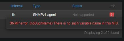

can not see any graphs in snmp device
  • Jack_lai
    • Nov 2018
    In my system....I use this template to monitor my snmp device ,but I can not see any graphs .........so Can anyone help to solve this problem!!!

    As you can see, the template has no graphs defined for it. If you select the template and go to the Graphs tab, you can define the graphs you need per each template item.

      DEAR ARTHURSL:
      Thank you for you replay.......But I have config cisco device ,the same use snmp ,and I ues Template
      ==>( Net Cisco IOS SNMPv2 (Template Module Cisco CISCO-ENVMON-MIB SNMPv2, Template Module Cisco CISCO-MEMORY-POOL-MIB SNMPv2, Template Module Cisco CISCO-PROCESS-MIB SNMPv2, Template Module Cisco Inventory SNMPv2, Template Module EtherLike-MIB SNMPv2, Template Module Generic SNMPv2, Template Module Interfaces SNMPv2)
      It auto create 110 graphs.......after I use this template to test
      "Template Module EtherLike-MIB SNMPv2"==>no graph;
      "Template Module Generic SNMPv2"==>no graph,
      "Template Module Interfaces SNMPv2"==>no graph
      So ,I do not know which template can auto create graph to let me check traffic???

        What equipment are you trying to monitor?
        If the monitored device can use SNMPV2, you can create a graph of each interface by using the template "Template Net Network Generic Device SNMPv2".
        However, since it uses the function called Low Level Discovery (LLD), it takes time to recognize the interface and automatically create items and graphs.
        Please leave it for about 1 hour or try to set the discovery rule update interval in Discovery to be short.
        In Zabbix 4.0 try using Check now for the discovery rule.

          My device is sophos XG firewall.......
          Last week when I use Zabbix 3.2 ,It created graphs automatically......than I install a new centos ,zabbix 4.0 ,I still use snmp template to monitor my sophos.......but it not any graphs

            DEAR ALL
            I found this problem,but how can I overcome this???
