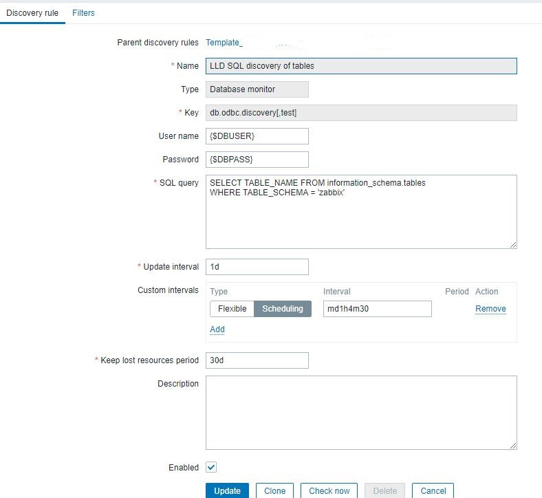

    Configuration of an item is in attachement. What am I doing wrong?

      I'm not sure that's your only problem but ODBC LLD key must be db.odbc.discovery[something,test], not db.odbc.discovery[,test]

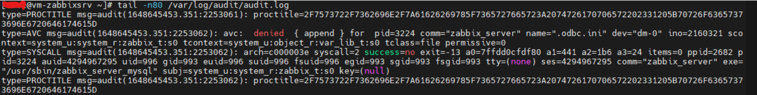

            Hi.
            Had same issue. In my case SElinux was blocking access to odbc.ini:
Name:	Screenshot 2022-03-30 160728.png
            Fixed it by executing these commands:
            tail /var/log/audit/audit.log | audit2allow -M mypol
            semodule -i mypol.pp
