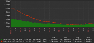

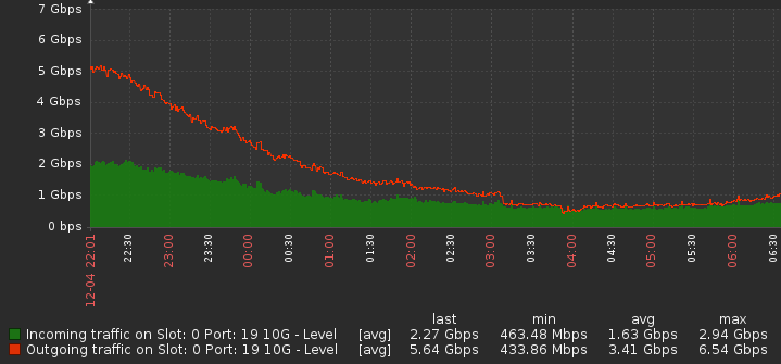

          Also don't forget that item ifHCInOctets.{#SNMPINDEX} must have preprocessing: "change per second" and "Custom multiplier=8". Maybe only this you asking for. To show speed in Mbps on interface... And you don't even need calculated item.
          Like this:
          But calculated item that i proposed will show used bandwidth in %. For example. We have 10Gbps interface. 5Gbps is 50% of total bandwidth. Its needed if wont to use trigger that alert you if interface if overloaded.
