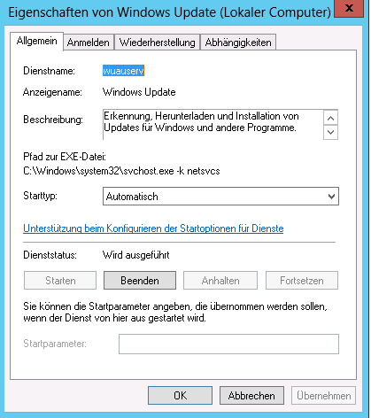

    since windows 2012 Server, i got always the value 6 (stopped) back, when i try to monitoring the windows update service wuauserv. This issue is only on Windows 2012 Server, on every older Win OS the windows update services monitoring for wuauserv works great.

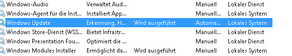

      Issue with monitoring Win 2012 service
      Hi aib,
      thank you for your answer!
      Unfortunately yes, I'm completely sure. How you can see on my attachements, the windows update service is named wuauserv and is up and running.

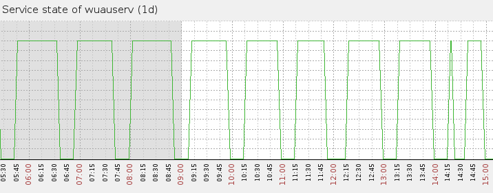

            Ups, my observation is not correct!
            The current service state in zabbix is actually 6 although the service running on the Win 2012 R2 64bit server.

              I tried the same thing with a 64 bit Zabbix 2.2.1 agent. Same problem. It starts correct with windows update service state 0 and after a while, i get state 6

              • Puemer
                • Apr 2014
                • 7
                Zabbix has done everything right!
                Windows 2012 R2 have a scheduled task, to start and stop the Windows Update Service. That's is the point!

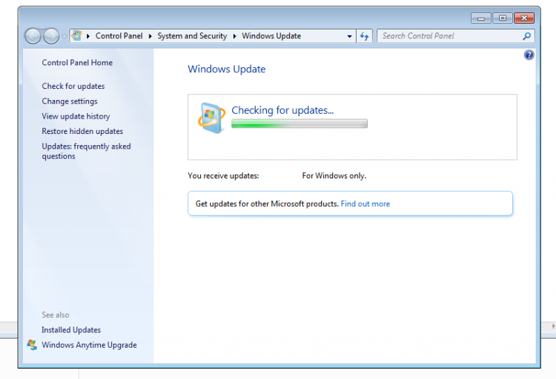

                        solved a problem... just start "check update" ... before windows update was disabled, but not service...
